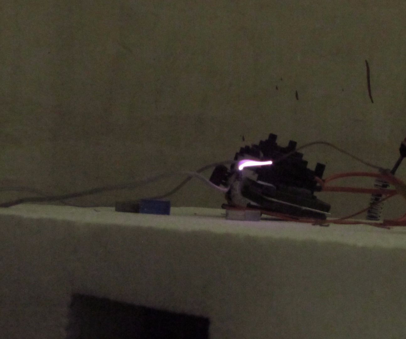

We can burn things specially black or dark colored stuff by simple 3V battery but this will heat up the diode after intensive use. In case we need to make a Laser engraver which needs to operate over long time, Requires assembly to cool the diode down. How ever by using Joule Thief we can increase its brightness and eventually draw the heat away from diode to the transistor used. In fact I was able to run a 12V 10 Watt LED with a single MOSFET , It was very bright , using a third winding.the video is
How ever the Mosfet got very heated and unnoticed by me . Died.....!!!
Anyway I am still finding such MOSFET for Laser Applications.

This is specifically a Infra-Red Laser found inside a DVD Burner. I removed all optics and finally wanted to fix with the focusing lens. We can use any lens depending upon requirement and focusing length.
Step 4: The Toroid , the Heart......
This toroid was found from a CFL driver. 3 Turns each for each Winding. If the figure does not work out. Reverse the wire. i.e interchange the Blue and Violate wires.

Step 5: All Connected and Its On
Connect every thing as per Circuit diagram.
IR laser from DVD/CD Burner connected to Joule Thief with BD139 and a 10K variable resistance. It can burn any black or dark color plastic,rubber etc. Take care of Eyes since these laser are lethal for eyes. It can blind you before your eye lid will close. --- I am Not responsible for any damage
You can take red laser or high power leds. Please also note to limit the supply voltage to 3 Volt Max else you will damage the diode. These diodes can bear 3.3V Max.
Step 6: Its Ready and Burning....................
Take care of Eyes since these lasers are lethal for eyes. It can blind you before your eye lid will close. --- I am Not responsible for any damage.
