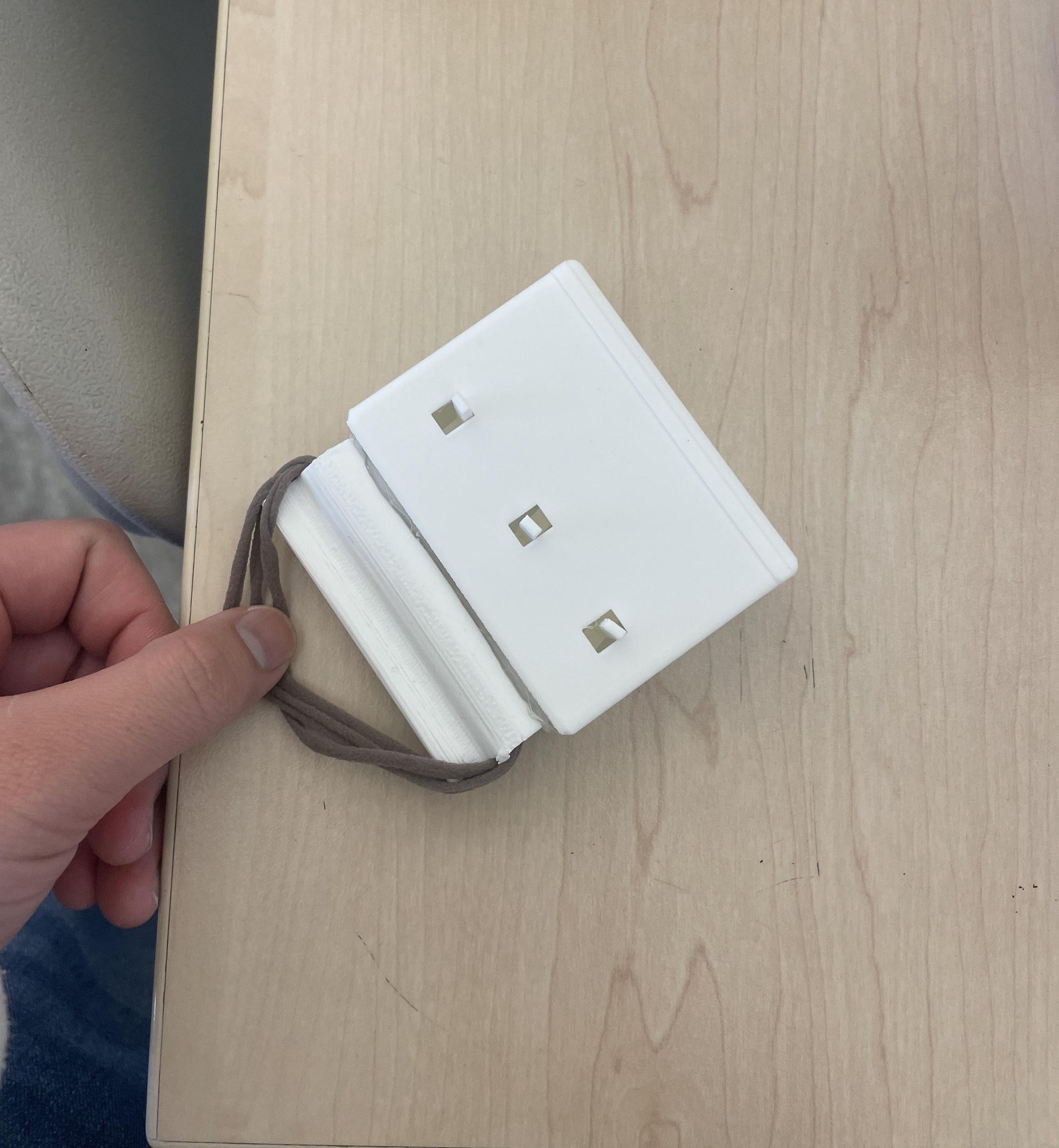

Step 1: 3D Print Box and Cover
The 3D design of the button should be linked in the materials but just in case that doesn't work for whatever reason, you can try this link: https://www.tinkercad.com/things/5jmFogUndMd/edit?returnTo=%2Fdashboard.
The largest piece(the cover) will be known as shape A.
The box without a top will be known as shape B.
The top of the box with the platform and the smallest piece will be known as shape C.

Step 7: Slide the Wires Through the Holes
There should be 3D printed holes on the side of shape A and B. Align the holes so that they lead right inside of the box and slide the alligator clips through them.
Step 8: Wrap Rubber Bands
For the button to have somewhat of retracting element, wrap rubber bands on the box. We used two from left to right and one up to down.
If needed, wrap copper around the rubber bands where it's touching the conductivity.
Step 9: Assemble
Assemble the button by taking shape B and placing shape C right over it before covering both of them with shape A.
Slide the wires through shape A and make sure the wires correspond with the hole on shape B.
Step 10: You're Done
Congrats!! You have a functional button.
