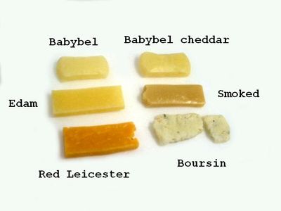

Austrian Smoked Processed Cheese
Not really cheese, but it dried quite well shrinking to 1/2" 67%
Edam
Quite a good cheese for drying shrinking to 9/16" 75%
Boursin
Hard to tell, as something mushy there wasn't any apparent loss of width, it was the thickness that diminished. However since it started plastered on a strip of packaging it's not that suprising.
Mini Babybel Original
Formed a bit of a crust, not a nice finish, shrunk to 9/16" 75%
Mini Babybel Cheddar Variety
Like the original it formed a bit of a crust, but more so, shrunk to 19/32" 79%
Red Leicester
Dried the best (and quickest) finishing at 9/16" 75%
Edam
Boursin
Red Leicester
