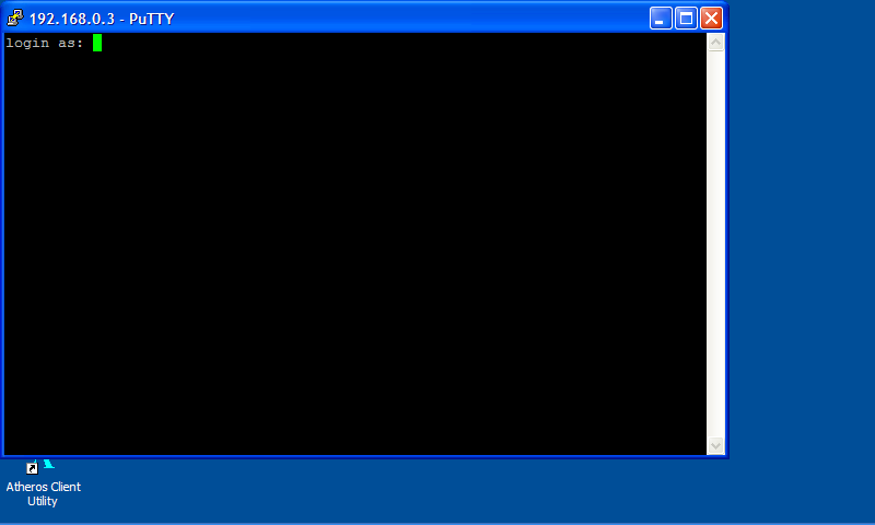

If you now click open, all being well, a black window will open and login as: will be displayed. Login now as you would normally if you were sat infront of the first computer.
You can now minimise this window.
