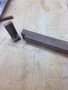

Step 4: Time to Cut the Clamp.
You should already have the .5" x .5" marked down the sides from the previous step.
Inside those lines, measure and draw the lines in the first image. These will create both parts of the c-clam as shown in the 4th image.
I used a bandsaw to cut these out but a small hack saw or coping saw would work as well.
The blade should be kept on the outside of the part to account for blade thickness when possible, when cutting the line that will separate the two pieces its alright to cut along the line. (you will need to sand down the surfaces so they fit later).
