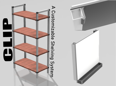

The Frame
The shelving system is built using different 3D printed connectors. There are 3 main connectors, 90 degree, straight, and a shelf bracket. There is also a shelf bracket cap connector. These connectors just slide into the aluminum square tubing. Please Note: Before buying the square tubing check that the 3D printed connectors will fit. The shelfs sit on top of the shelf brackets and get screwed in.
The Accessories
The accessories are attached to the aluminum tubing by clips. The peg board has 2 attachments for it. A pencil holder and two hooks. The attachments slide in the holes have a friction fit. You can also add 1 inch wooden dowels if you want to add a different type of hook. There is a clip on whiteboard that includes a marker holder. There is also a rack of hooks and a pencil holder that clip in. Even better though, there is a file holder! I have modeled some clips so you can attach your own pencil holders or whatever you want!
