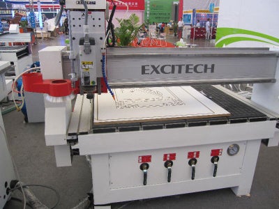

Step 2: Find a CNC Machinist
CNC machining is becoming very popular these days, just do a web search in your area for "CNC router."
