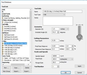

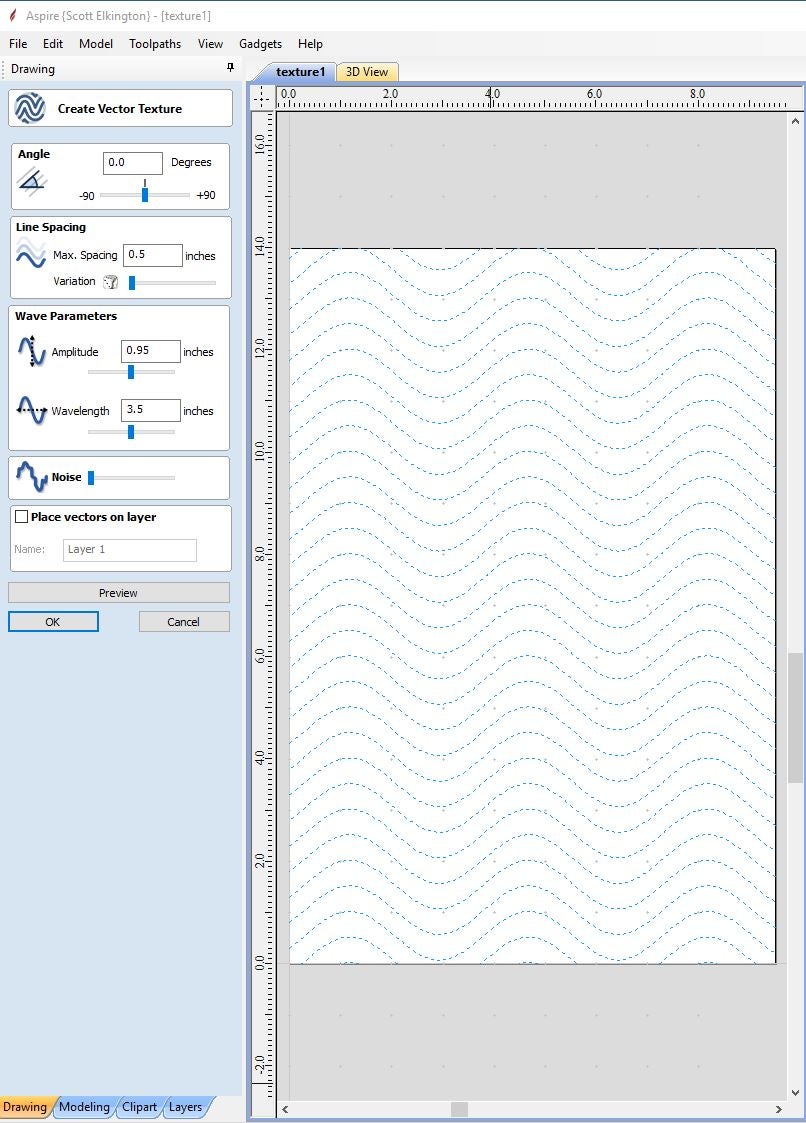

I spent a number of hours designing the samples with Vectric Aspire using the create vector texture tool and the texture toolbox gadget. I used a 91 degree 1.5 inch v groove cutter to cut all the textures. you can see in the screen shots the approximate settings for a successful cut with that bit. It did take quite a bit of experimenting to get the samples I wanted.
