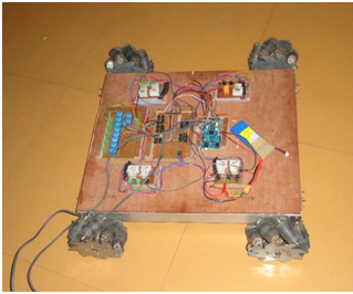

Step 8: CONSTRUCRTION OF THE REMOTE
The frame of the remote was constructed using light weight high strength plywood. We first fabricated the remote as per our need and then bolted the components such as Xbee, Arduino, LCD and switches onto it. We made a remote that could be opened from the front and Velcro was used to seal it tightly. Slots of sizes corresponding to the devices were made and then they were glued down using hot glue. All the required circuit connections were done and the entire circuit of the design was placed inside the remote. To make sure that our remote had an attractive appearance we covered it up using seat covers.
Step 9: CONSTRUCTION OF THE FIELD
For the field to be similar to an actual field, 100x50x4 cms thermocol was used for easy modifications. To create the crop irrigation field, 40x30 cms rectangular area was cut side by side. 6 mm plywood of the exact dimensions as that of the thermocol was attached below the altered field to ensure greater strength to the thermocol.
All the electronics was fitted inside the shed which was built using 4 mm plywood. As a water reservoir is usually present in an irrigation area, a small water resource was made using a plastic box. The plumbing work was done by cutting slots that fitted the pipe diameter exactly, thus no pipes could not be seen on the surface of the field. Later the slots were covered with tissue paper and a coat of fevicol with water was applied. Allow the coat to dry for a day. Apply 3-4 coats of tissue paper for better strength and water resistance. The wiring of the field was also done in the same manner as that of piping. To prevent leakage of water from the field the polyethylene plaster, which is a good water resister was applied. A small fountain was built near the water reservoir using gravels and grout. Once the final coating of tissue paper is applied on the complete field, corresponding colours of the field was painted using poster colours. Before painting, ensure that the coat of tissue paper is completely dried. For a darker shade apply another coat of colour depending on your taste.The built shed is placed on the planned area in the field. The field is water tested. If any leakage is found put another coat of polyethylene plaster to seal the leakage. If no leakage is found, the field is filled with mud and two different crops are ploughed. Sprinkle required amount of water every day for a steady growth of the crops. The field can be fenced along the edge of the field.
Step 10: CIRCUIT DIAGRAM
There are two main circuit diagrams in this entire project. One is the circuit of the remote and the other the field's circuit.
The remotes circuit consists of a LCD, an Arduino, a Xbee, IC 7805, Switches and loads of wires. The remote's circuit is shown in the images using Fritzing.
The field circuit comprises of an Arduino, a Xbee, IC 7805, motor driver, moisture sensors and temperature sensors. Also a suction pump is connected so that water can be pumped onto the filed.
