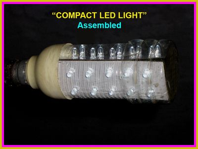

In Step-4 you can see the reverse side of the Board, and how the LED's are soldered.
Each legs of the 4-LED's are soldered in the middle and so on......................
Step 5: STEP-5
In this step the light board is folded into a triangle and fixed by clear cello tape to hold it in place.
The Capacitor and Resistor are put inside the bottom housing taking care that they should not
short circuit. Place a small plastic piece between them.
Cut a plastic bottle from the top so that the diameter fits the bottom housing and tape it to the base.
Step 6: STEP-6
In this step your COMPACT LED LIGHT is assembled and is ready for use,
Fix it in an electric bulb holder and switch it on and ENJOY the soft light.
