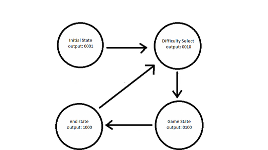

Step 1: Device Structure
The main functionality of the device is controlled
within the state driver. This contains all 4 stages of the games. The intro state, the difficulty selection state, and the end state. The State Controller is a FSM which outputs the current value of state as a 4 bit binary bus. The functionality of the device can be broken down into several segments.
The button segments are always active, and they allow the user to select game difficulty, enter the difficulty selection mode, and reset the device when necessary. The button segments take in an input and outputs to other modules.
The difficulty Driver is a state machine with three states: easy, medium, and hard. This module has two functions. The first is a driver for the seven segment display to display the words for the actual difficulty. The second function is to output a 16 bit bus to the game module.
The final modules are all related specifically to the seven segment display. The end, init, and game drivers all map to specifically to the seven segment display. The outputs are sent through the SSEG select module, and depending on the state being sent from the state machine the module sends four of the buses to the SSEGDriver.

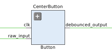

Step 2: Button Modules
The button module is probably the most finicky module in the whole device. The designer has to take into account debounce to create a button that goes high only when they push it. We found that 100 mS appears to be enough to verify that the user has actually pushed the button down. The button module is the only part of the program where the module can run independent of the state controller.
The module needs the following inputs and outputs:
inputs:
raw_input(This is mapped to the actual buttons on the device)
clk(this is the 100 MHz clock that is always running on the device)
Outputs:
debounced_output
When the input raw_input goes high, it acts like a chip enable and a counter begins counting(up to 100 mS). If the counter overflows and the input raw input is still high, the value debounced output goes high. When raw input drops back to low, both the counter and the value of debounced output drop back down to low.

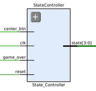

Step 3: State_Controller
The state controller acts as the brain for the whole device. Its I/O are as follows: The state machine takes several inputs used to change the internal game state. These include the game over, center_button, and reset inputs. It also includes the clock which is how it acts to switch between the states. There is only a single output. The state output is a 4 bit bus that the other modules use to define their behavior. The basic cycle can be seen in one of the images above. When the resets are included the module changes significantly, but for the purposes of understanding the basic gameflow, the image works pretty well.

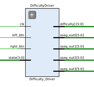

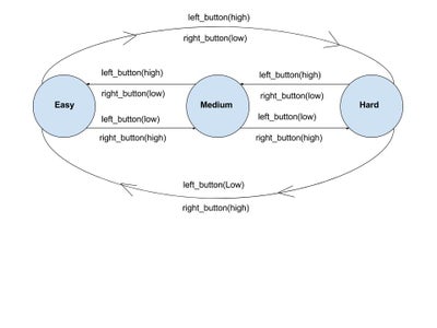

Step 4: Difficulty Driver
The difficulty driver module is a state machine that outputs the current difficulty when in a particular state. It also outputs the buses used to identify the text that will be sent to the seven segment display. The left button and right button modules are used to switch between states. If either of the two buttons is high then the machine follows the logic in the diagram above. If for some reason the module enters an unknown state it defaults back to the easy state. because of the extremely short time for the debounce on the button modules, if the player pushes both buttons, the state will simply follow the order in which the buttons were pushed.
The difficulty driver outputs 4 six bit buses that represent letters in the word for the current difficulty. The possible words are Easy, Fair, and Hard. The module internally uses a display_word module to scroll through a larger number of letters. When the display_word module changes one of the four buses out, the difficulty driver output changes as well.
The outputs for the 16 bit difficulty bus are dependent on the state the module is currently in. If in the easy state, the output is a bit mask that will specify the pattern for only the 4 least significant digits in the bus. If in the medium state, the output is a medium bit mask which specifies the pattern for the 8 least significant digits. If the state is hard, the bit mask uses all of the bits in the bus.

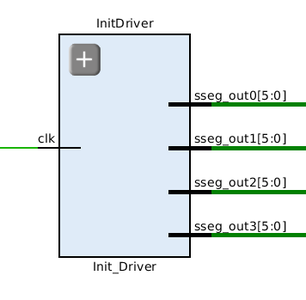

Step 5: Initial State Driver
This submodule is dedicated to displaying "HELLO" on the seven segment display when the state controller is in the 'init' state. The only input to this module is a clock signal. The clock signal enables the driver to effectively scroll its text every 500 ms across the seven segment display. The four outputs represent a character currently being sent to display on the seven segment.

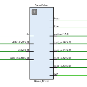

Step 6: The Game Driver
This is the module which controls the countdown timer, pattern generation, and pattern matching of the game. When the state controller is in the 'game' state, the game driver is turned on. This game driver will then read the difficulty input and use it to generate a pattern for the user to solve.
Once the pattern is generated, the clock signal is used to drive an internal countdown timer which is displayed on the seven segment. The countdown timer starts at 240 s in hard mode, 60 s in fair mode, and 30 s in easy mode.
The user input corresponds to the actual positions of the 16 switches on the Basys-3 board. Whenever a switch position has changed, the game driver will test to see if the new input matches the pattern. If the pattern matches, then the win output is pulled high and the state controller changes to the 'end' state. If the pattern does not match, then the degree to which it does not match is evaluated. If 2 or more switches are out of position, the countdown timer will increase in speed by a factor of two. If this timer reaches zero, the lose signal is pulled high and the state controller switches to the 'end' state.

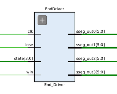

Step 7: The End Driver
This module is tasked with displaying "SUCCESS" or "FAILURE" on the seven segment display. It does this based on the current state in addition to the win and lose signals.
When the current state matches the 'end' state, the driver will evaluate the win and lose signals to determine which message to display. If the win signal is high the message will be "SUCCESS". If the lose signal is high the message will be "FAILURE". When both signals are high, which does not happen, the message will default to "SUCCESS". We are not completely heartless.

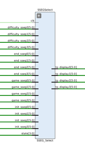

Step 8: The SSEG Select Driver
This module is in charge of displaying the proper message on the seven segment display. It uses the seven segment outputs from each of the other drivers combined with the current state from the state controller.
The 16 seven segment inputs are subdivided into groups of four. Each group corresponds to either the difficulty driver, game driver, init driver, or the end driver. The 4 seven segment outputs are driven according to the value on the state input bus. For example, when the state matches 'difficulty' the difficulty seven segment inputs are routed to the module's outputs.

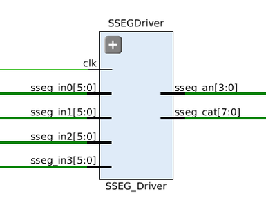

Step 9: The SSEG Driver
This module is directly connected to the Basys-3 board's seven segment display. It is tasked with generating the correct timings in addition to anode and cathode configurations to display messages.
The module has a clock input as well as 4 seven segment character inputs. The clock input is divided internally to 200 Hz for a non-flickering display. Since the display is common cathode, every 1/200 seconds the anode configuration is switched. For example, if the current anode configuration is "1110" (left digit is on), after 1/200 s the configuration changes to "1101" (2nd from the left is on). This process runs continuously from: "1110"=>"1101"=>"1011"=>"0111"
The 4 seven segment character inputs are routed through a large case statement which maps the the character into the correct cathode configuration. Each cathode configuration is 8 bits wide since there is a decimal point on the Basys-3 board's display.
