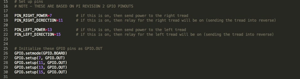

Rp and Lp determine whether power is fed to the motors or not. When Rp is on and Rd is off, the right motor turns forward.
When Rd is on, it activates the relays and when Rp is on, it turns backwards.
The same applies to Ld and Lp.

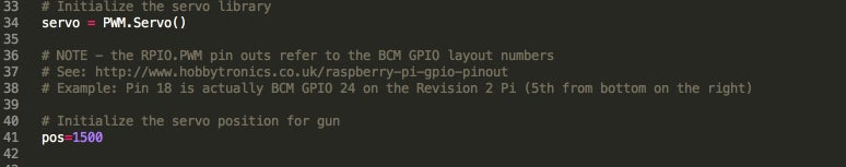

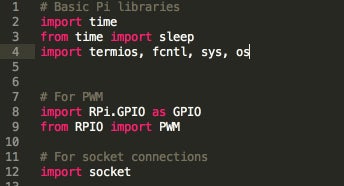

Raspberry Pi server
On the server itself, we need to do a bit of configuration. Specifically, we'll be dealing with some PWM. The easiest thing to do is to include the RPIO library. We can download it and install by the following:
$ sudo apt-get install python-setuptools
$ sudo easy_install -U RPIO
In this project, we also chose to use a wifi connection as well. You can use the ethernet port, but for us we wanted the full untethered experience. We went with the EDIMAX wifi dongle, available at your local eBay. You can use the Raspbian Wheezy's built-in WLAN configuration tool to connect to the SSID of your choice.

# Basic Pi libraries
import time
from time import sleep
import termios, fcntl, sys, os
# For PWM
import RPi.GPIO as GPIO
from RPIO import PWM
# For socket connections
import socket
This first part is for importing the libraries we need.
Next, we'll set up our GPIO pins (note that these are based on Pi Revision-2 layouts. Check which revision you have here, and which layout you have here). Make sure that you're plugging them into the right pins, or changing your pin configurations correctly below:
# Set up pins
# NOTE - THESE ARE BASED ON PI REVISION 2 GPIO PINOUTS
PIN_RIGHT_POWER=7 # if this is on, then send power to the right tread
PIN_RIGHT_DIRECTION=11 # if this is on, then relay for the right tread will be on (sending the tread into reverse)
PIN_LEFT_POWER=13 # if this is on, then send power to the left tread
PIN_LEFT_DIRECTION=15 # if this is on, then relay for the left tread will be on (sending the tread into reverse)
# Initialize these GPIO pins as GPIO.OUT
GPIO.setmode(GPIO.BOARD)
GPIO.setup(7, GPIO.OUT)
GPIO.setup(11, GPIO.OUT)
GPIO.setup(13, GPIO.OUT)
GPIO.setup(15, GPIO.OUT)
After that, we'll initialize our servo motors (note the comment on the GPIO BCM layout):
# Initialize the servo library
servo = PWM.Servo()
# NOTE - the RPIO.PWM pin outs refer to the BCM GPIO layout numbers
# See: <a href="http://www.hobbytronics.co.uk/raspberry-pi-gpio-pinout"> <a href="http://www.hobbytronics.co.uk/raspberry-pi-gpio-p...</a"> http://www.hobbytronics.co.uk/raspberry-pi-gpio-p...</a>>
# Example: Pin 18 is actually BCM GPIO 24 on the Revision 2 Pi (5th from bottom on the right)
