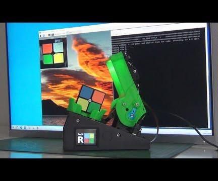

This is my second Rubik's cube solver robot; This time I wanted to make it very small, simple, fully 3D printed, and inexpensive..... to attract more people into robotics, especially students.
The overal project considers the robot, to be scalable, to accomodate different budjet levels.
This instruction relates to the base version; Main info, for this Base version:
  • It requires a PC for the cube status entry, via webcam or via mouse, and to "feed" the robot with the cube solution (based on Kociemba solver).
  • An ESP32 development board, programmed in Micropython, controls the robot and the two servos used for all the movements.
  • The interraction is supported by a GUI, coded in Python; A setting page at GUI helps with the basic robot settings.
  • The robot is energized via the microusb port, the same is used for the communications. A more robust solution is to enrgize the servos via an independen power supply (details in the How_to_make_... .pdf file in Step1 below)
By excluding the self solving Rubik's cubes, and the robots requiring modified cubes for gripping, this is one of the smallest Rubik's cube robot I've seen so far.
The name of this robot is CUBOTino: Apart from the obvious CUbe+roBOT, "ino" is the italian suffix standing for small..... a "small" touch recalling my origins and the very small robot dimensions.
