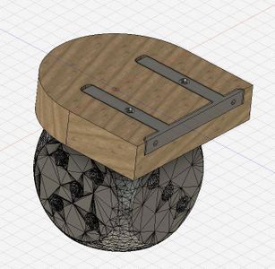

Step 1: 3D Fusion 360 Design

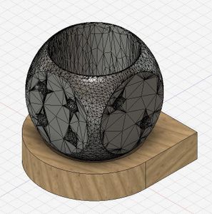

I've imported the STL file of the dice cache-pot, scaled it to 200% to fit my cactus, and designed the support arround it.

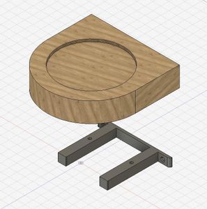

The bracket has 2 holes for wall fixing, and 2 holes to fix it on the wood.

First carve the verso : make the pocket for the bracket and cut the outline of the whole piece.
Second : flip the piece and carve the hollow circle.
