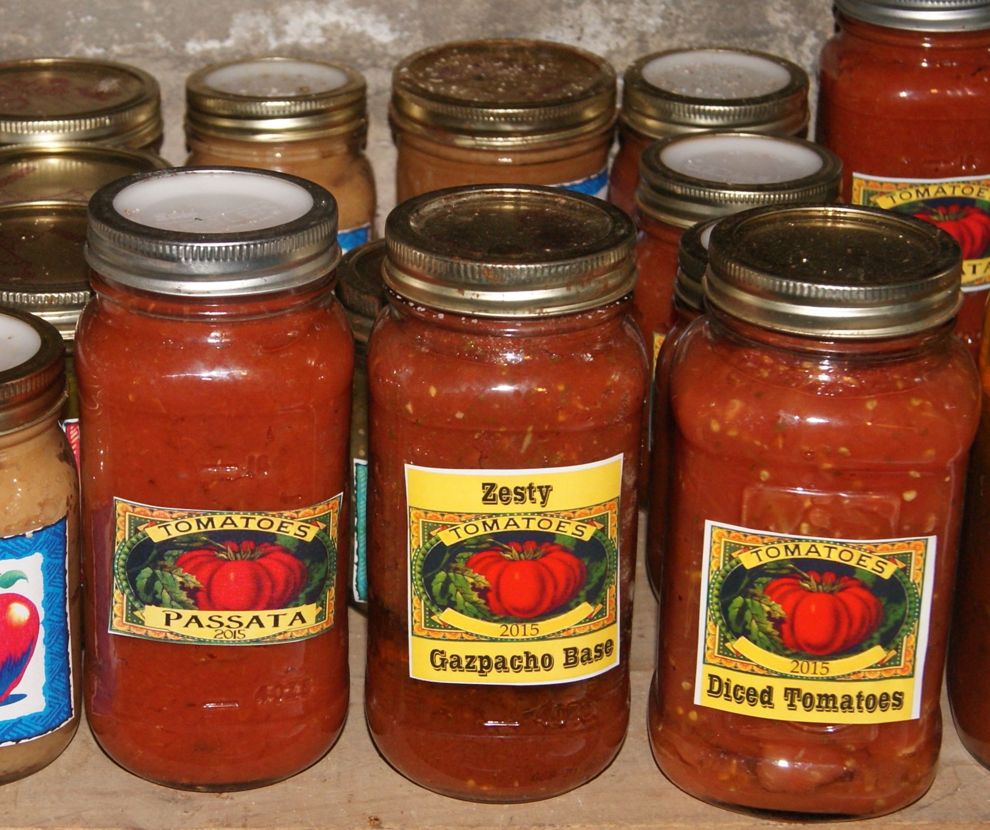

Jar rings can stiffen or split before lids reach their end of life. I keep a box of spare rings on hand should such a failure happen. I think I've used two in the five years I've been using Tattler lids.
Step 2: Proper Fill Level
I have found that Tattler lids will surely seal if you fill jars to 3/4 inch below the rim. If you follow the common recipe directions of to a half inch or quarter inch below the rim, your jars will often not seal with Tattler lids. These empty spaces are defined for metal lids which are thinner.
I have a stainless steel canning funnel whose lower rim will sit at just about three-quarters of an inch below the jar's rim, so I fill to just below that. Another handy quick measure is to fill to the start of the jar's metal ring thread, no matter what the jar size is.
