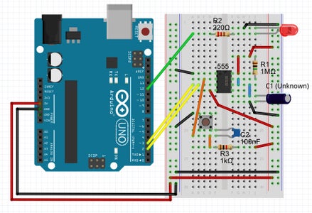

Step 3: BUILDING THE CIRCUIT
In the image above you can see the circuit mounted on a breadboard. It is very simple and easy to implement.
You can also click the .ino file to see the source code.
The circuit is powered by the arduino itself (VCC = + 5V).
The trigger circuit comprises a switch in conjunction with a 1k resistor and a 100nF capacitor.
The capacitor in the terminal 5 (CV) of 555 is not required for this project.

Hi, thanks for sharing this great little project. :) I have built the circuit and although it does work, I have found the trigger unreliable. But here is a quick fix: just add a pullup resistor (10kOhm) between C2 and a button. :)

Thank you for this! Didn't work at all without it.

maybe use a n channel mosfet or bjt instead of direct button and puls it shortly from the arduino.
if one holds the button to long, the charge will not go down at 2/3 of vcc but keep rising. and will delay the falling edge. this coud be a problem at small farads
