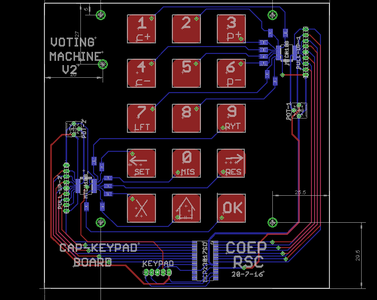

Step 3: PCB Designing
Here comes the most important part. It is extremely important that the PCB should be designed following all the guidelines. Since all the capacitances involved are generally in the range of picofarads, care should be taken while placing the touchpads.
First lets take a look at the keypad board we designed. The whole board has been shown so that you get an idea of what the ideal distance between 2 pads should be. As you can see, we took into consideration the area of the pad, so that our finger can be ideally detected. Secondly comes the distance between two pads. Note that when you touch the pad, the electric field changes in the area around the pad as well. So make sure that no two pads are too close to each other.
The next image shows the close up of the tracks between MTCH108 and the touchpads. Note that the track lines are kept at some distance from the pads, so as to prevent the false signalling.
One of the boards shown is for the voting buttons. In that board, you can see that the ground plane does not pass anywhere near the MTCH108. This has been done after going through a lot many pdfs regarding pcb designing.
Another important instruction is that avoid using a voltage regulator on the board of the capacitive touchpad. The signal distortion/ripples occuring due to the voltage regulator are far too much for the small capacitances to handle. As a result the ic cannot detect the changes occuring in the capacitance.
