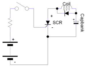

6-21-07 UPDATE: Added an SCR into the circuit (new button; the old one short-circuited). Details on the SCR on step 3.

6-21-07 UPDATE: Below is the SCR (Silicon-Controlled Rectifier) that I salvaged from a light dimmer (model no. Q2008LT). Basically what it does is, it triggers the capacitors to discharge when it receives a small pulse of electricity above ~.5V. This way, the only electricity going into the switch is just as low as the power source you use to trigger the SCR. You can find SCR's in certain electronics, or you can order one online for less then 50 cents, BUT BE SURE NOT TO CONFUSE SCR'S AND VOLTAGE REGULATORS (and triacs); THEY BOTH DO TOTALLY DIFFERENT THINGS, BUT THEY LOOK EXACTLY ALIKE!! Also, don't worry about the middle pin; we won't be using it.
Using the circuit I provided will, unfortunately, ruin your switch and make the coilgun inefficient. But by using the new setup with the SCR, it will work much more efficiently. Be sure to take a look at the schematic (the 2nd one)!
NOTE: Elaborate on the diagram; I have not updated it to reflect the added components.
6-24-07 UPDATE: DO NOT USE THE SPECIFIED MODEL OF SCR; IT IS ACTUALLY A TRIAC (different kind of device; looks the same). Try using one of the SCR's on THIS page.
