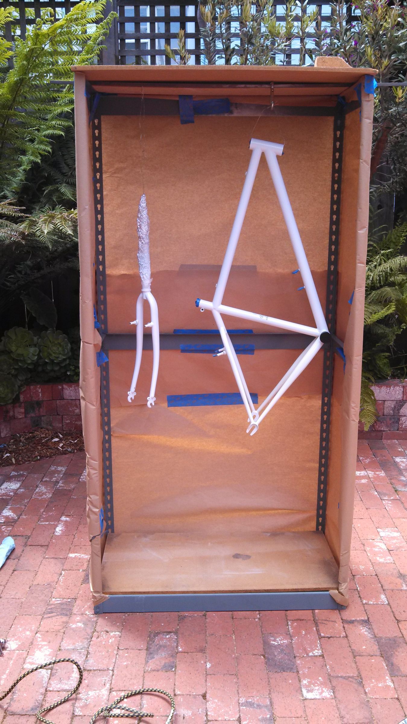

Step 3: Prepping, Painting, Stripping and Finishing
Before deciding that this project was going to be a Captain America themed piece, I was going to just paint it black... so some of the following steps represent that approach and are optional.
Using a degreaser (like Simple Green), a Scotch-Brite pad helps strip off any unwanted surface grime. Rinse with water and dry afterwards.
A uniform dulled matte surface was achieved after stripping almost all of the black paint off with the Scotch-Brite pad and some paint stripper. One may be content with the raw steel finish after the initial clean. In this case, the black paint helped dull the sheen and finish of the steel (which can help resemble the appearance of the battle-worn Titanium shield of Captain America). I did not buff it after this step.
When the steel finish is achieved to your liking, use a couple coats of a clear spray (in this case, I used a matte lacquer) it to prevent the raw Chromoly from oxidation, etc.
