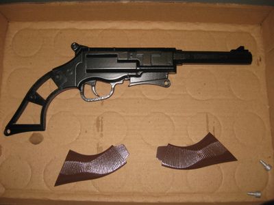

Step 4: Filling, Painting and Buffing
Filling:
- Use some Testor's Contour Putty, fill in any gaps between mated parts. Smooth out the putty and let dry. Then lightly sand the surface.
Painting:
- Paint the Pistol using a matte black spray paint designed for plastics.
- Paint the grips using a brown spray paint designed for plastics.
Let dry, and you now have a base for your pistol on to rub and buff.

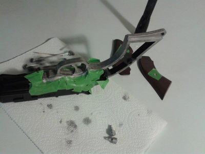

Rub 'n Buff:
- Wear disposable latex gloves.
- Tape off the parts of the pistol you don't want to be steel coloured.
- Apply some Pewter Rub 'n Buff to the grip center using your finger or a q-tip, spread the waxy paste around to cover evenly. Repeat until the area is covered.
- Apply some Autumn Harvest (or Grecian) Gold Rub 'n Buff to all the other areas of the pistol, be careful not to overlap with the steel color.
- Apply some Pewter Rub 'n Buff to the faux screw in the grip handle using a q-tip or toothpick.
- Buff the sufaces with a clean rag to polish the metallic finishes.
- Glue the grips handle pieces to the Pistol to complete the assembly.
