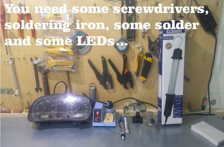

Step 2: Tools You Are Going to Need
These are the tools you are going to need:
- You can use cheap bit set like in the picture, you should use the appropriate screwdriver bit so you dont strip the screws
- Sildering iron, nothing special, any solderin iron with small pointi bit will do
- Desoldering pump for removeing the old LEDs, and some solder for the new ones
- Multimeter for testing the polarity
Thats about it, at least for our cars dash

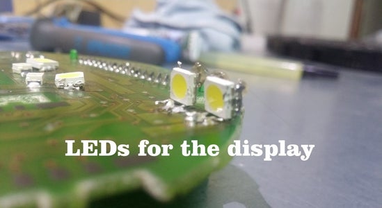

Step 3: Choose Your LEDs
You can check this picture and compare with your original LEDs so you can buy the same size only diferent color, we used diferent type of LEDs because we couldnt find any in our local stores and we didnt want to order online and wait for them for two weeks, so we took some leds from a cheap workshop lamp.
I would definitely recommend buying original LEDs because of the size difference, other types may not fit.

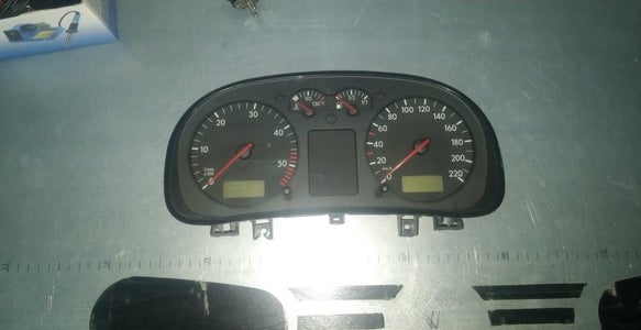

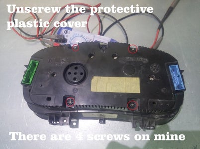

Step 4: Removeing Your Dashboard and Preparations
Google how to remove your dashboard, if you own a Golf Mk4 check out this video for a detailed explanation:
https://www.youtube.com/watch?v=Unb4Sweqwu4

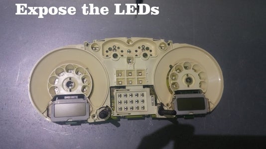

Once you removed the dash, expose the leds and prepare for desoldering

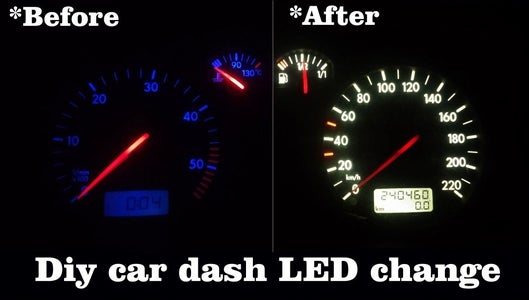

Step 5: Whitch Ones Do You Want to Change
You can mark the ones you want to change, we replaced all the blue ones but we kept the red ones

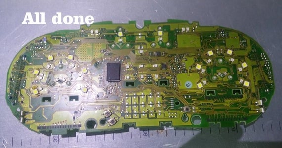

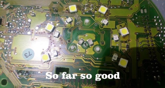

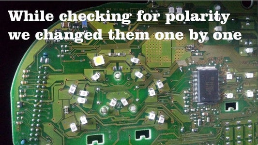

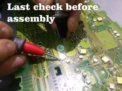

Step 6: Desoldering and Testing
Desolder one LED and solder the new one, use your multimeter to test the polarity of the original one and solder the new one with the same polarity.
You can also plug your dash in your card and turn on the lights to test your progress, since the LEDs are connected in series of four, if you mess one up you wont know whitch one you messed up, so check every led after soldering it.
Step 7: After You Are Done Soldering
When you finish your soldering, check again if every led works with your multimeter, then check again in your car by connecting your dash and turning the lights on, if every thing works, you can assemble your dashboard

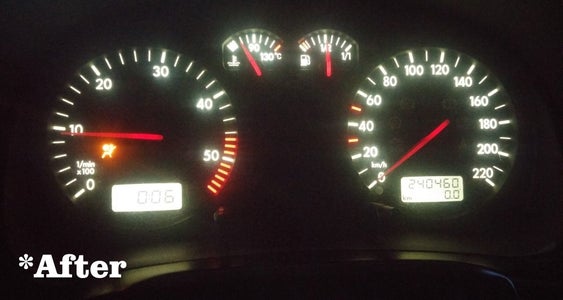

Step 8: Finished
Thank you for reading, this is my first instructable so i hope i didnt make alot of mistakes, i made the video half a year ago, and i thought it could still help someone if it was easier to find
