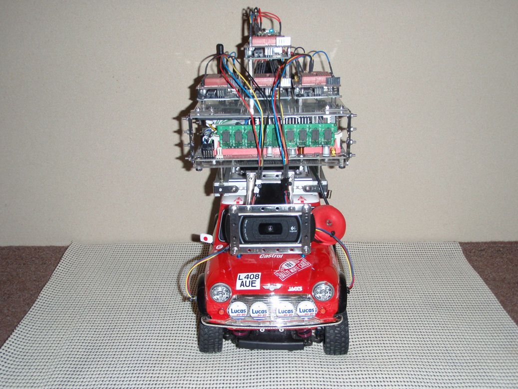

I have converted the Excel Simulation Program for Car Trajectory to Processing code.
In this Yogurt version, position adjustment to the starting point is omitted, and I have succeeded up to 18 rounds!
The composition of this version is same as that of Full Chocolate version.
Please refer to this for detail composition. (4 Arduinos are used.)
I only revised the Processing code.
So, I show you in this Instructables only the video of automatic driving up to 18 rounds and the Processing code for that.

I have converted the Excel Simulation Program for car trajectory to Processing code.
The car trajectory can be simulated as shown below.
The attached Excel is applied in previous version of Car No.05, and I have converted this to Processing.

This is the Processing code for Car No.05 Yogurt Version.
Processing code
CARNO05_07.pde
Note:
I made some adjustment for car initial position,
i.e.
G1x = float(round(xp))/1000 + 0.20;
G1y = float(round(yp))/1000 + 0.10;
