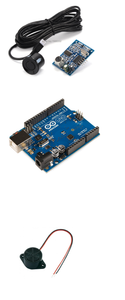

You'll need:
- 1 Arduino
- 4 Waterproof Ultrasonic Sensors and their drivers
- Buzzer

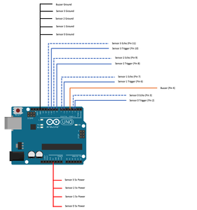

Step 1: Build a Test Rig
Before drilling holes in your bumper for the sensors and running wires through your car I would strongly advise building a test rig to trial your reversing sensor with.
Above is the wiring diagram of the sensors and buzzer to the Arduino
