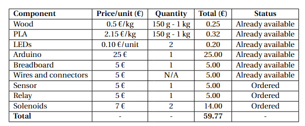

  15. Bill of materials

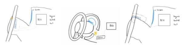

First of all, the design of the component arrangement must be decided. To make the device easily adaptable, placed in a comfortable location, and of an acceptable size that is not intrusive, three possible solutions are proposed. In the first, the system would be embedded in the car's steering wheel. The second would be external to the car and mounted alongside the dashboard. The last option would be strapped to the steering wheel with straps. The image above shows the initial design ideas illustrating these possibilities.
Green color is used to highlight the best option for each feature.

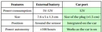

Sensor
To be able to choose the appropriate sensor, the features related to it are taken into account. It can be seen that there is a clear winner on the table.

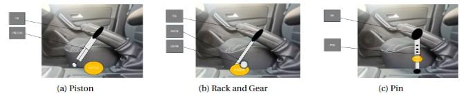

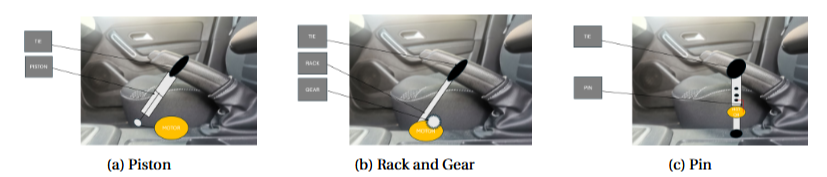

When it comes to locking the handbrake to prevent the driver from driving, various combinations of mechanisms were proposed.
A piston with a motor that locks it in different positions, which would be attached to the handbrake. Also, a gear system with a rack and a gear. A passing bar through another, with a pin that locks them together. A bar clamping system inspired by an existing one on the market.
By seeking robustness but avoiding excessive complexity at the same time, the table above is obtained.
Some sketches of the concepts can be seen in picture.

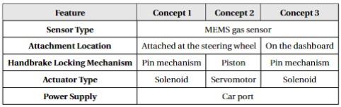

Once the locking mechanism system has been decided, the actuator that will activate it to make it function must be selected. Thank to the table can be seen that the solenoid is the best option.
After considering the best options from each of the previous tables and combining them, three possible final concepts are obtained.

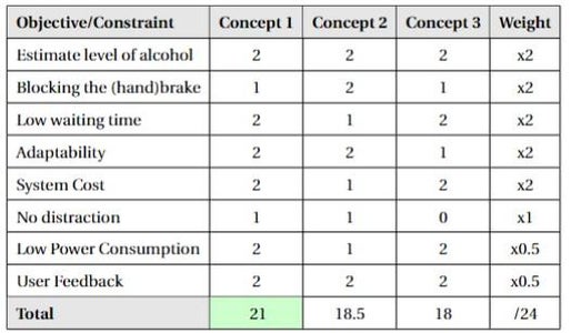

The table comparing the concepts outlines the various potential approaches to achieving an effective design, based on the key problems analyzed earlier.
To be able to make a selection, a quantitative assessment is made by giving a weight to the different costraints. This way, the best concept can be chosen.

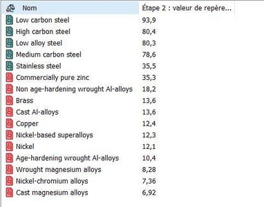

Another important aspect is the economic part, therefore another Ashby diagram can be made
evaluating the price in function of the fracture toughness (Picture 8).
Finally, with the comparison of the two Ashby diagrams obtained, a list of materials is obtained for the blocking mechanism (last picture ).

Conceptual design: preliminary concepts and selection
Several preliminary concepts were considered for the design:
  1. A piston with a motor capable of locking it in different positions, attached to the handbrake.
  2. A gear system involving a rack and pinion mechanism.
  3. A passing bar through another, secured by a pin that locks them together.
  4. A bar clamping system inspired by an existing design on the market.
To ensure robustness while minimizing complexity, the pin mechanism was selected and further developed as the most suitable concept.

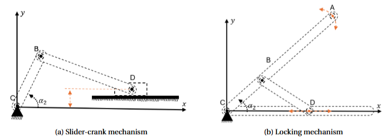

As our main goal is to follow the motion of the handbrake and lock it when needed using a pin mechanism to externally control its motion, we require a component capable of rotating approximately 0 to 90°. This exceeds the actual maximum rotation angle of a handbrake which is around 30 to 45 degrees from its fully disengaged to fully engaged position because we lack access to its center of rotation and aim to act only on the handbrake bar to interrupt its motion with the support of the external handbrake structure of the car, thus a larger angular range is necessary for our system.
To ensure compactness and accommodate the solenoid, we based our mechanism on the slider-crank mechanism.This mechanism effectively converts rotational motion into translational motion, allowing easier control as the solenoid manages the permitted translational motion
To allow full rotational motion in the crank (360°), the conditions |DB| − |BC | > |C D| sin(α2) and |DB | > |BC | must be satisfied. Thus, they must also be respected in our model. There are joints at B, C, and D to allow the motion of the system. From point A, a part of the locking mechanism will be attached to the handbrake, enabling it to recover the load applied to the handbrake to release it. The load will then be transferred to component AC, which will further transfer it to DB, and subsequently to CD, where a solenoid will be placed. The solenoid will act as a pin through holes in CD to block and unblock the overall system.
To reduce the load applied at point A and supported by the system, we will place two of these sliding mechanisms in parallel. This configuration will divide the effort by two and balance the structural load
Furthermore, some considerations must be made for the position of point B. From a static analysis since component DB transfers the load to CD, the position of B is crucial. As CA is subjected to bending, the farther B is from A, the greater the load applied to joint B. Therefore, B should be as close as possible to A to minimize this effect.
From cinematic analysis, the motion of the slider can be written as
⇒x_D = |BC|(1 − cos(α2))+ |DB |/|BC | − sqrt((|DB|/BC)^2 − (sin(α2))^2)
For an optimal design, the position of B should ideally depend on the type of handbrake. However, to create a standard device, we will position B such as for a given length |DB| it will be as much close as possible to A while allowing a correct motion of the overall system.
We chose |DB | ≤ |C A|/2 so that when α2 = 0, the length of |C D| + |DB | will, at most, equal |C A|. This choice ensures the compactness of the design.
Thus, for |C A| = 15cm, by using the previous constraint we find |DB| = 7.5 and |BC | ≈ 4.5cm
This provides a maximum volume of clutter for the blocking mechanism, based on dimensions of L = 20 cm, l = 12 cm, and H = 20 cm, resulting in a total volume of 4,800 cm³.
PS(|CA| = 15 cm and l = 12 cm is an estimation based on the handbrakes we commonly used in our daily life)

As shown in the table, PLA is a sustainable material for being natural, recyclable, biodegradable and renewable, while needing few energy to produce and process it. In addition, its CO2 footprint is very low.
On the other hand, steel is an energy consuming material with a high CO2 footprint while being not
Biodegradable and renewable. But can still be recycled.

Step 12: Bill of Materials
