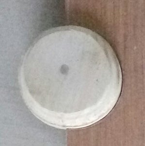

Step 8: Wheels and Support
For overall strength and support, I used a 10mm thick wooden strip, on which I fixed the cabin and 3 wooden wheels
Placed some 19mm plywood as support to frame as shown. It can bear the load from the cars and frame
One can use this to fix on wall.
Use fevicol or glue for every thing, for strength
