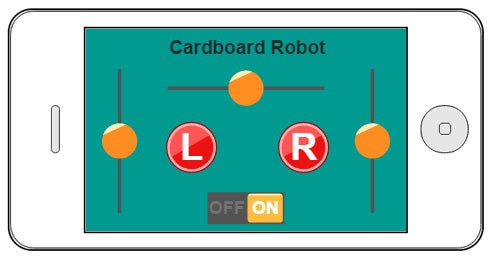

CardBoard The Hero is a robot controlled by an Android phone via an app called "Remote XY". CardBoard will move its head, hands and turn LEDs on from the eyes.

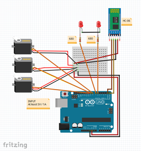

Step 4: Wiring & Coding
Please look at the diagram and wire altogether and upload the code
Download the app at:
FREE VERSION
https://play.google.com/store/apps/details?id=com....
PAID VERSION
