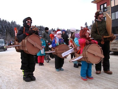

Inspired by Aidan Chopra's cardboard Grumman F4F-4 costume, we decided to make cardboard airplanes for YuKonstruct's entry in this year's Winterval Santa Clause Parade.
We used free cardboard and YuKonstruct's Epilog laser to make the planes and they were a huge hit with the kids and everyone watching the parade.

Step 6: Finished Plane
