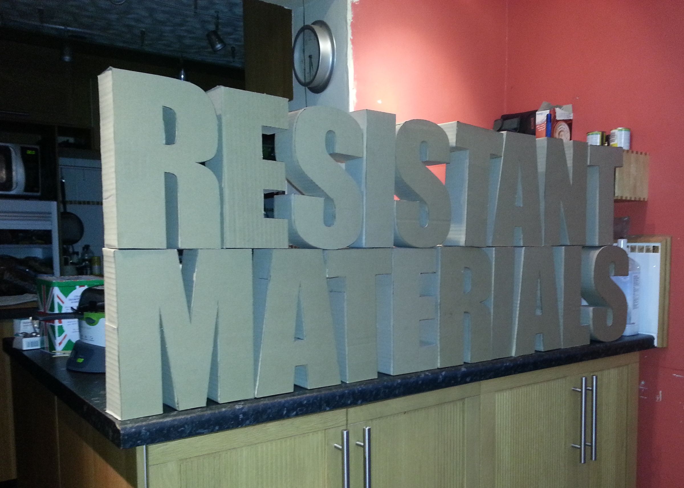

After being inspired by Jude Pullen a Dyson Designer I decided to make my own classroom decoration.Resistant Materials All letter are in Impact font laser cut from recycled cardboard from around school and the sides were made from locker packaging also scrap card. It has taken 9 Hours to fabricate the letters using hot glue to hold them together. Didn't record the laser cutting time.

First step it to remove the corrugated card leaving just the outer paper to create a rebate
Step 2: The Build
Next step is to construct the letters. Hot glue into the rebate and slowly work around the letters. Best to get all the difficult tight blends and shapes done before finishing the larger areas. Letter S was the easiest letter to make.

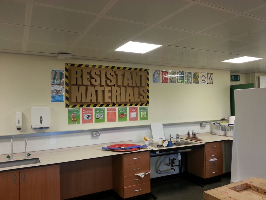

Finally, all letters made and on display enjoy and get making have fun pat here is the link to Jude Pullens site http://www.judepullen.com/designmodelling/
