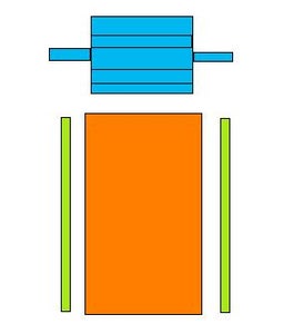

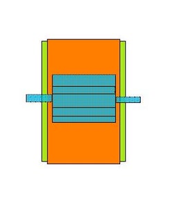

Step 4: Putting It All Together
Now you're done for the most part! You're going to put one end cover on your housing where you think the middle is. Put your rotor into the housing. Top it off with the other end cover. Open your valve, blow into it and watch it go or make an air tank!
