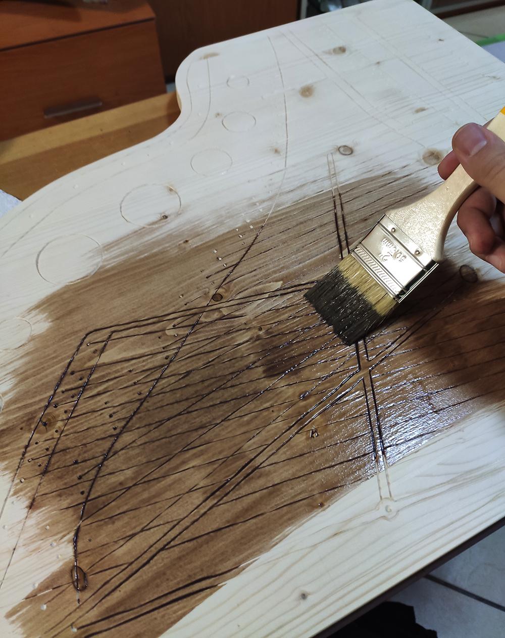

Step 4: Darkening the Wood
I decided to give the wood a few layers of darkener. I should have probably avoided darkening the "white" keys of the piano, but the final look is not bad at all (kinda authentic). I also decided to spread an additional coat on some specific parts of the piano, as shown in the last pictures. Finally, I carved out again the strings to give the piece a bit more contrast. I'm really happy on how it turned out!
