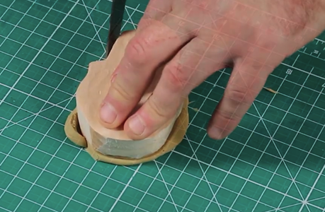

Step 1: Drawing Part
Let's draw the skull as it will look like with the carbon paper. Also, draw a frame with the ruler.
Step 2: Now With the Help of Knife Start Removing Wood
Detail whittling knife would help you out in marking the spots where we're going to remove some wood out of the skull's face. Just follow the lines drawn by you before.
Step 3: Take a Gouge to Get Rid of Wood
My hubby usually keeps working with BeaverCraft tools, as this time he took the gouge to remove some wood. We should work out a skull's face to be in relief.
Step 4: Keep Going With the V-parting Chisel
In order to reach some hard to get spots, we'll take the other chisel, called v-parting tool. Teeth zone seems to be not that easy to work with. So be patient, do your best in this.
Step 5: Dangerous Part With the Jigsaw
Now we need to get our skull out of wood in order to work with some dough. Please be careful, it's easy to get hurt by the jigsaw. Or you can leave it as it is and attach some dough to the surface later.
Step 6: Happy Ending
Here we are ready to make some cookies. Choose your recipe and do some dough to enjoy cookies this evening.
