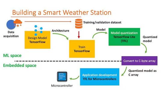

The original process is described in Chapter 3 of the “TinyML Cookbook” where the author gives a detailed explanation of all the development stages of a TF-based application for an MCU, including:
  • Import of weather data from WorldWeatherOnline
  • Dataset preparation
  • Model training with TF
  • Model quantization with a TFLite converter
  • Using the built-in temperature and humidity sensor on an Arduino Nano
  • Using the DHT22 sensor with a Raspberry Pi Pico
  • Preparing the input features for the model inference
  • On-device inference with TFLu
For clarity, the process can be represented as such a scheme.

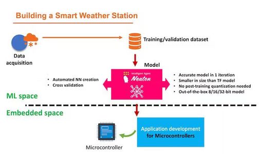

However, I thought about how to improve the proposed workflow and reduce the number of steps by eliminating the need for quantization. Here’s the workflow that I created with Neuton TinyML.
Step 4: Step-by-step Workflow
The main aim of my experiment was precisely the creation of a model to check the metrics. My workflow on the Neuton TinyML platform can be described in the following steps:
  • Upload a new solution and uploaded a training dataset.
  • Upload a validation dataset.
  • Select a target variable “Target”.
  • Choose the target metric “Accuracy”, enable the TinyML mode, and select 8-bit depth.
  • Start model training.

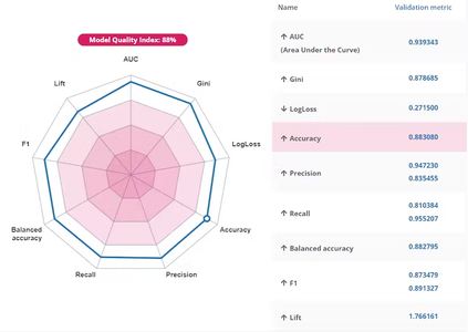

Step 5: Here Are the Metrics of the Resultant Model:
Step 6:

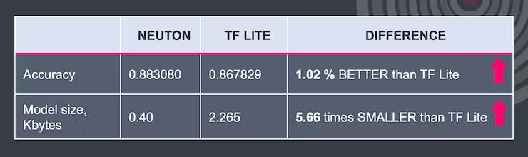

To my mind, the most noteworthy outcome that I got is that the model turned out to be super compact (0.4 Kb) without any additional compression or quantization, and the small size didn’t affect the accuracy at all (which is 88%).
If we compare the models created using the approach of the author of the book and my approach, we get the following results.
Thus, I can conclude that when using the Neuton TinyML platform, I was able to speed up the process of creating a model, as well as get better results in terms of size without compromising accuracy.
