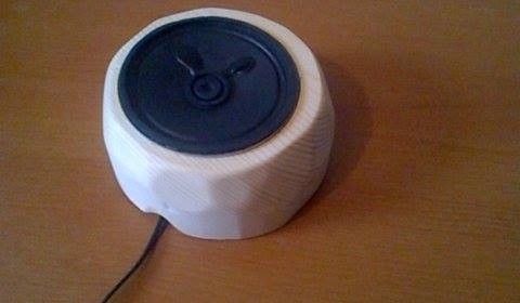

Step 4: Step 4 - Making the Concrete Mould
cut two pine blocks to each other via PVA. use a hole saw to drill a 64mm hole in the centre of the block. when this is done, use a tenon saw to take away any material around the outside to get a circular, curved edge. like the picture above. use a belt sander, file or sand paper to get a smooth surface. make sure you taper the block as it makes it easier to get out of the mould after.
insert the piece into a vacuum former. if you are not able to complete this step by your self, get someone else to do it, eg friend, parent or teacher. wait until the plastic is bouncy then pull up the mould, turn on the vacuum and wait a few seconds. use a Stanley knife to get the wood out then tape the holes up.
make some loops using wire and insert into mould, spacing them out. this will act like support to prevent your concrete from breaking. add water to your concrete mix, and then out into the mould. tap the mould on the table a few times to prevent air bubbles. this also removes moisture from the mix, making the concrete set harder. take the concrete out of the mould when set.

Step 6: Step 6 - the Circuit
I ordered the mono speaker from kitronic and I only had to solder on the AUX, speaker and battery pack. use hand drill (5mm) and drill a how where you want your speaker. for example the middle of the hand. glue the speaker into the loop and wait until it sets. feed the wires threw from inside of the hand to the speaker and solder these on. this is the step where you glue the top pieces of acrylic to the concrete. using the 2.5mm wire. make three 50mm strips, bending one end about 60 degrees. using the hand drill, drill three 3mm holes where the wires will sit. insert the wires from inside of the cast concrete into the holes you drilled. use araldite o secure them in place. wait until its dry then test your speaker.
