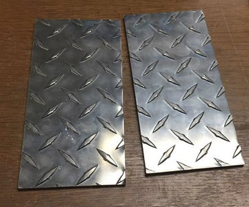

  • Sheet metal (I'm using ¼" aluminum diamond plate)

Cut two plates of sheet metal to the same size. These will be the floor and ceiling of the jail. Mark a line around three sides of the perimeter. On this project, I marked 1 cm from the edge. Next measure off and mark the locations for the bars using a compass. This makes it real easy to get precise spacing. On this jail, the bars are spaced at 2 cm.

Using a center punch (I like the automatic kind), punch a hole for each bar and drill the plates. If you use flat plates, you can clamp them together in a vise and drill both at the same time. Since I used diamond plate, I had to countersink with a larger drill bit to provide a landing place for the bolt heads.
