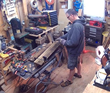

I don't show this here, but I started out by breaking down about 5 old pallets, all the same size and type so the pillars looked the same. I didn't really need these to look brand new since my coffin is very weathered and just wouldn't look right. Once I painted them though they looked pretty nice in my opinion.

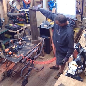

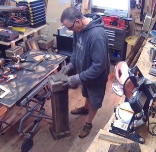

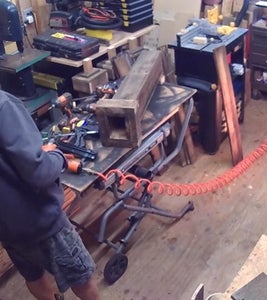

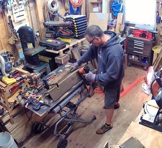

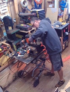

I cut the main box of the pillar to 36" long and the width of a standard pallet board. These boards were 3/4" thick.
I then clamped 2 pieces together and nailed them on edge. I used a nail gun so it went pretty fast.

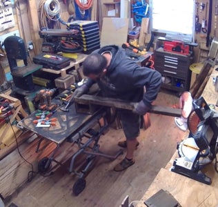

Then I would add another board and clamp & nail it.
I kept doing this until I had a box.

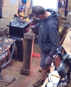

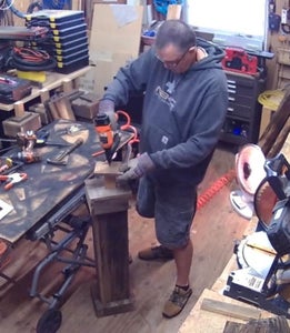

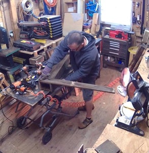

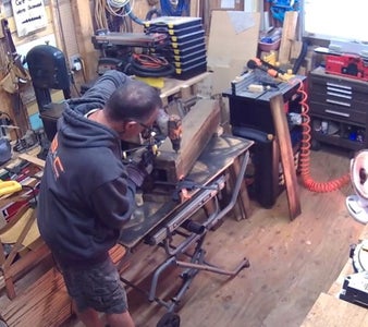

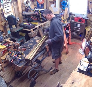

I used the pallet stringers, which were just 2x4's, to make a base around the bottom of the pillar since they were thicker than the other boards. Each piece of Pallet wood is typically not the same width or thickness, so I just laid the board on the box and made a pencil line where I needed to cut it instead of measuring.
After getting all 4 sides cut and fitting nicely, I clamped them together, drilled pilot holes so the wood doesn't split, and screwed them together with 2-1/2" drywall screws.
After those were screwed together, I put a couple nails from inside the box into the trim to hold them in place.
I did the same steps for the upper trim but used the smaller boards from my pallet which were about half the width of the boards I used on the main box. I think you can see what I mean from the photos.
I didn't screw these together, I just used nails for this.

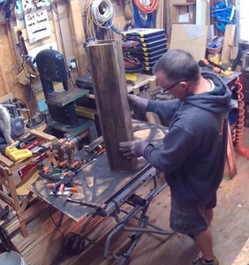

Step 3: Putting a Top on the Box

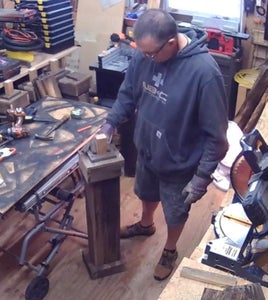

I needed to make a top for the pillar to finish it off and wanted a pedestal for a styrofoam skull to sit on.

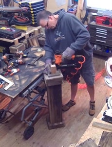

I just used the left-over pieces from my pallet to make a top that went on the main box of the pillar. I just laid the board on top of the box and marked where I needed to cut it, and then nailed it in place.
I then stacked another piece of wood on top of that which was cut smaller. It looks like steps or a pyramid.
I then took another piece of wood to make a pedestal. It was just a piece of 2x4 scrap that is approximately 1-1/2"W x 2-1/2"D x 4"L. I used this for a skull, but you could probably put a solar light on this or not use the pedestal at all and be finished.

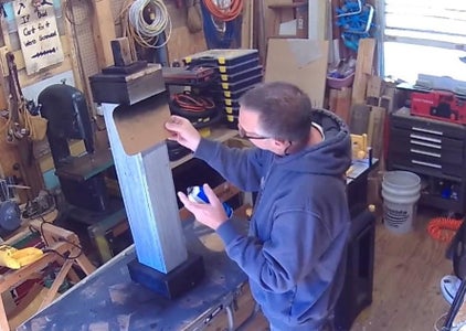

I finished these up with some spray paint. Flat gray for the middle portion and flat black for the upper and lower parts.
