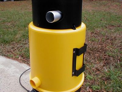

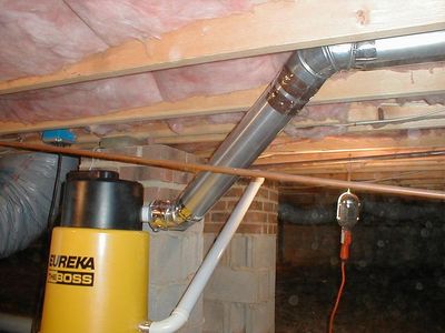

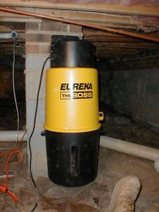

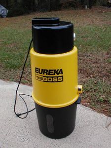

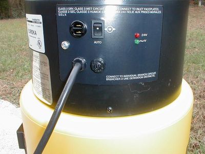

Step 2: Power Canister
Here are some photos of my power canister. I installed it in the crawlspace under the house.

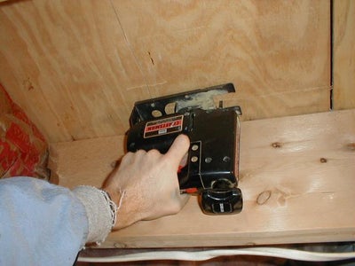

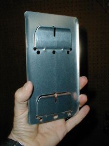

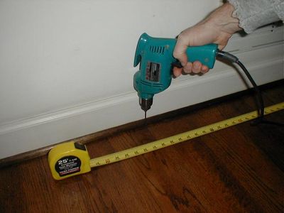

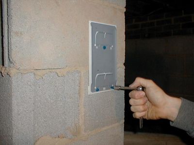

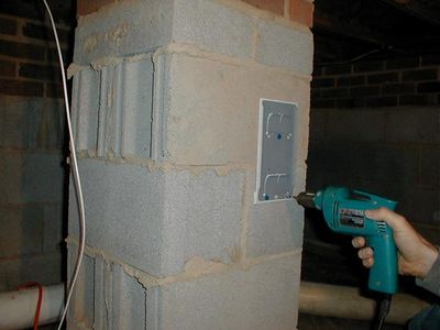

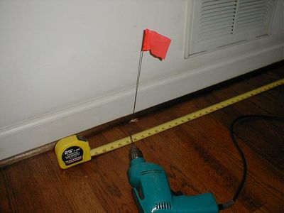

Step 3: First Inlet Receptacle
First figure out where to run the trunk line plastic pipe and where you want the inlet receptacles. Be sure to place enough inlets so the flexible hose can reach everywhere in the house.
The photos tell the story...

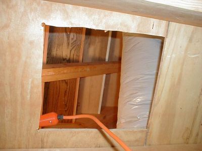

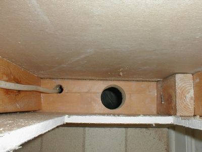

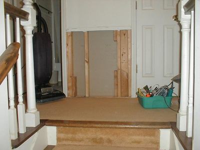

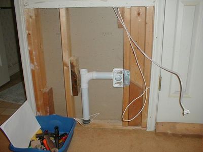

Step 4: Next Inlet Receptacle

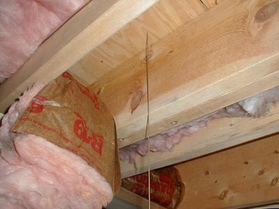

I opened the walls in a closet, installed the next inlet receptacle, and snaked the main pipe trunk line up to the second floor.
The surgery continues...

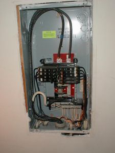

Step 5: Electric Connections
Oh, by the way, you must know how to do electric wiring safely, and according to your local codes. I am not explaining it here. If you don't know, then don't attempt the project.

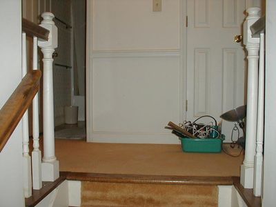

Step 6: Inlet on 2nd Floor
Had enough yet?...

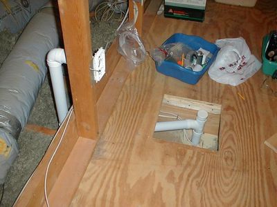

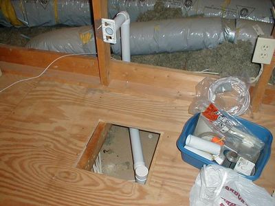

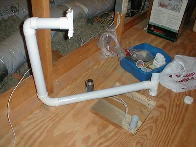

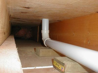

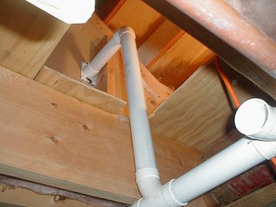

Step 7: Last Inlet Receptacle
Finally, up into the attic.

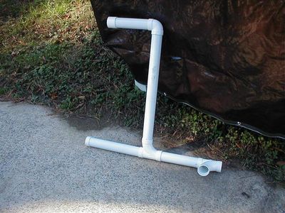

One little tip... I installed "tees to nowhere" as cleanouts at strategic places throughout the system. I capped them off with silicone caulk, rather than pipe cement. If ever something gets really clogged in the pipe in the future, this should ease the snaking operation.

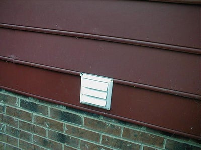

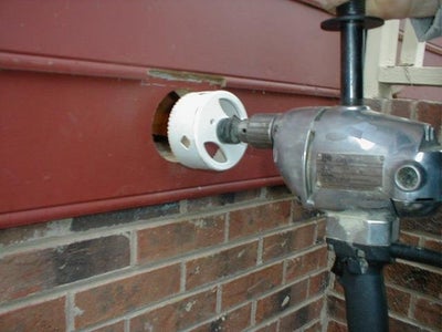

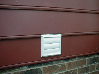

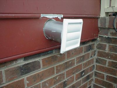

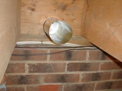

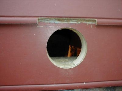

Step 8: Exhaust to the Outdoors
I cut a hole in the house wall, installed a dryer vent, and piped it to the canister in the crawlspace. This was my idea. It is non-traditional. Copy it at your own risk.

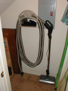

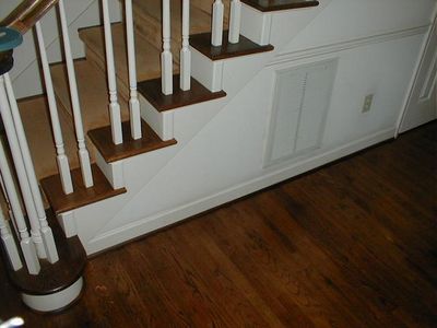

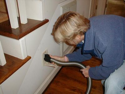

Step 9: Finished
The maiden voyage.
The system has worked great for 3.5 years now. It is well used and abused, and it keeps on ticking.
Good luck planning and installing your own system.
