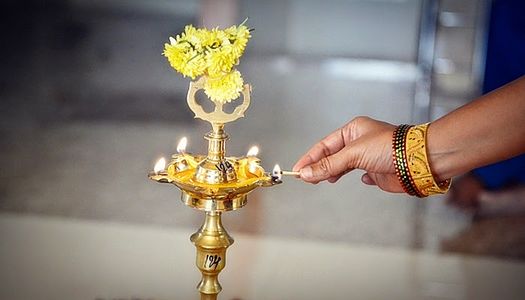

The ancient tradition of lighting oil lamps has a special significance. "Knowledge removes ignorance just as light removes darkness", as it is wisely said.
In India, any auspicious ceremony is commenced by the lightning of lamp. Hence came the idea of why not make it digital or control it wireless with an app in mobile.
By doing so we are maintaining the tradition as well as trying to do some fun and innovation in it.

Step 3: How a Traditional Ceremonial Lamp Looks
