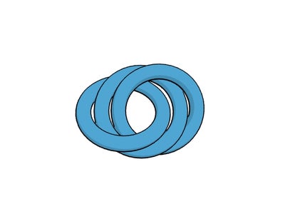

1. First Step is to make a three ring mobius and flatten it like so.

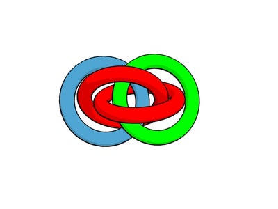

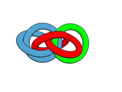

2. Now take the rightmost ring and fold it down.

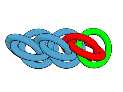

3. Next, add a ring through the last two rings keeping the ring you folded down, down (so you weave through it backwards basically).

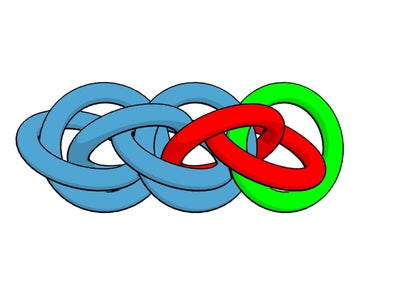

4. Now rotate the weave backwards, and weave the next ring the very same way, around the eye.
5. Once more.
6. Now turn it back to the top, and repeat step three.
7. And once more with step four.

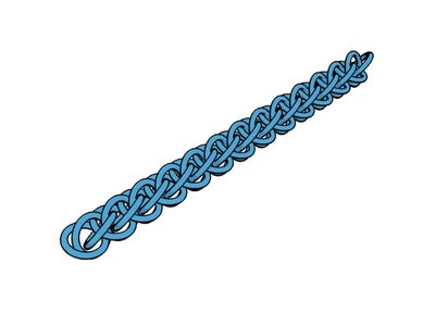

you got it: Keep this pattern up over and over and over and over...and you're done.
