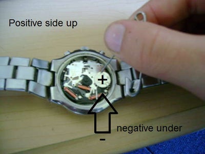

Step 2: Unscrew the Back
2# Unscrew the back
Put your scissors ilke in the picture below. Push hard on it and turn counter clock wise.
Step 3: Take Off the Battery
3# Take off the battery
Take your wire and slide it gently under the battery. Pop it out.
Take a look at the battery and take in note the serial number. Go buy it, put the battery with the positive side up and put everything back.
There you go.
