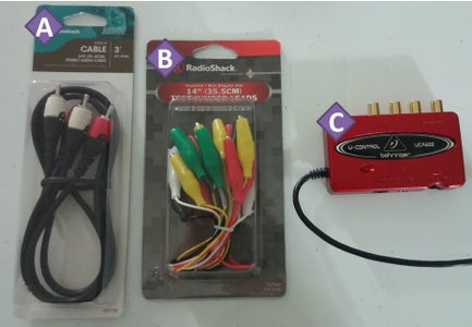

Oscilloscope/Poorman's Scope
To see the chaotic attractor you need an oscilloscope, and we can make a cheap one with these parts...
#DescriptionStoreSKUQty.
A3 Ft. Stereo Patch Cable, Dual-RCA Plugs to Dual-RCA PlugsRCA*1
B14" (35.3CM) Insulated Test/Jumper Leads278-11561
CBEHRINGER U-CONTROL UCA222**UCA2221
C1 Mega-ohm Resistor271-1356
Note*: You can get the same RCA cables at your local dollar store as well.
Note**: You can get a UCA222 online, however any USB Audio Adapters that has a stereo input will work. Some are sold in music instrument stores such as Sam Ash.
Note***:This resistor is actually in the bag of 500 resistors listed in the first table

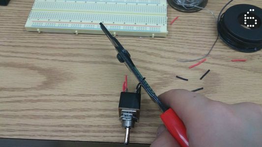

Step 2: Create Breadboard Switch
RadioShack does not have any DPDT (double-pole, double-through) switches that can fit into a breadboard. We'll use panel-mount DPDT switches and solder 22AWG wires to them instead.
  1. Cut 3 pieces of 1.5" (4cm) red 22AWG wire.
  2. Cut 3 pieces of 1.5" (4cm) black 22AWG wire.
  3. Use the wire stripper to strip the tips, and hook the wires to the DPDT switch connectors as shown in the images above. One side is for +9V (red), and the other for -9V (black). Use the pliers to help.
  4. Solder the wires to the switch connectors as shown in Figures 3 and 4.
  5. Use the wire stripper to strip the ends of the wires to have about 8mm (1/4") exposed. (See Figure 5)
  6. Plug the switch into the breadboard. Do all the connectors reach into the board? Can you flip the switch without it falling out? (See Figure 1)
You may realize that it is not necessary to solder on all six connectors for the circuit to work, but I strongly recommend doing so for structural integrity.

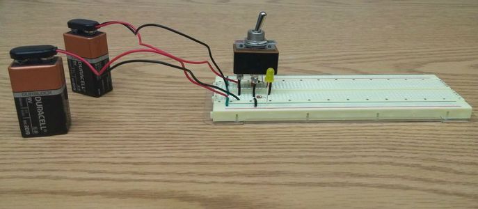

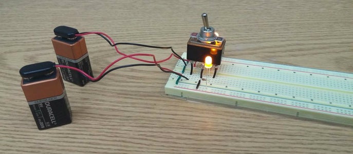

Step 3: Assemble -9V GND 9V Source
Here you will put together the circuit that connects the 9V batteries to the rest of the board. We use LEDs to help indicate that the batteries are working and to remind us to turn the switch off when you're done.
Note that you need to use the 220 ohm resistors in series with the LEDs, or else too much current will flow through them and they will burn out.
Follow the the images above which provide a breadboard layout, schematics and pictures of the actual board. Use whichever image your most comfortable with to build the circuit.
Make sure to test that BOTH LEDs turn on. Note that LEDs won't work if you plug them in backwards.

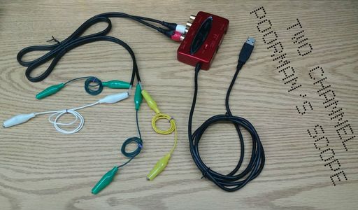

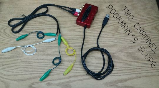

Step 6: Poorman's Scope
If you have an oscilloscope skip this step.
The Poorman's Scope is a great replacement for an oscilloscope in many situations. The bulk of the work in this step is to make probes that will fit into the RCA slots of the USB Sound Adapter.
The software we use to see the chaotic attractor is called Soundcard Oscilloscope and the latest version can be found here.
1. Grab an RCA cable and snip off the tip of one end.
2. Look inside. As you can see there is a conductive wire in the center, and conductive wire along a circle around it.
The inner conductive wire holds the signal, and the outer is ground. We will access both.
3. Cut the outer casing about 1/2" (1.27cm) along the wire, but not deep. Just deep enough for you to bend the outer casing off. Get the ground conductive strands out of the way, and cut again to get to the strands at the inner core. NOT TOO DEEP, you don't want to cut the strands.
4. Go down another 1/2" (1.27cm) and this time only remove the outer casing. You should now have access to both the inner and outer strands. Make sure they don't touch! Cut the ground strands short enough that they won't touch the bottom of the signal strands.
5. Do this again for the other RCA cable.
6. Connect the green alligator clips to the ground strand. Green is ground by convention!
7. Connect the RCA plug into the INPUT of the USB Soundcard Adapter.
And you're done! You just made a Poorman's Scope.
Making the probe can take a bit of practice. You can get the same RCA cables at a dollar store, and keep cutting till you get it right.
