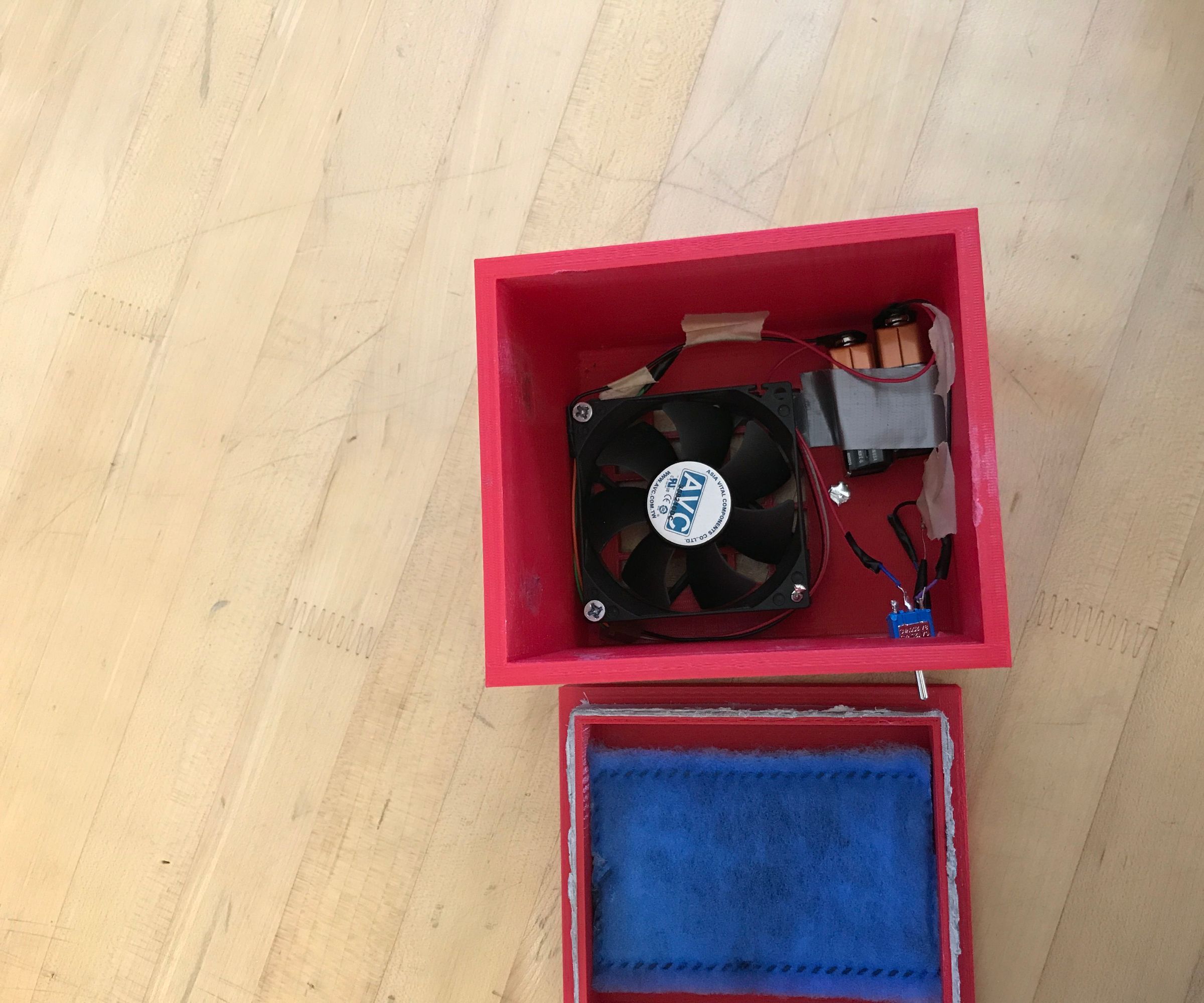

Step 2: Working With the Box
  1. Tape the box shut so it doesn't open
  2. Then cut the box 2/3 of its size
  3. Measure the fan on the box and trace it on the box.
  4. Measure the filter and trace it as well.
  5. cut the filter hole out and for the fan hole you will cut it like a vent
Step 3: Install Filter and Fan
  1. You have to put the filter in the hole you made. You put it black facing out and blue side faces the inside of the box
  2. The fan is put inside where the vent holes were made. The air should be blowing out and not inside the box.
Step 4: Connecting Batteries to Fan
1. You need 2, 9 volt alkaline batteries
2. stick them together and connect them with the jumper wires to the main connection of the fan the batteries should say which side is positive and which is negative
3. make sure to use electrical tape to pass the current.
4. In the fan the black cable is the negative and the red cable is the positive charge and the white cable is nothing you can leave that alone.
5. You can use breadboard if you are experienced with it and know how to use it. if you don't know how to use it, it is not required to turn on the fan.
6. The fan should turn on if it doesn't there could be a few problem
  • cables might be not connected to battery or fan
  • Batteries don't work
  • put cables in the wrong spot
  • fan requires more batteries to work
