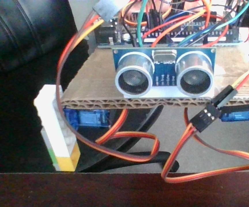

Step 2: Assembly
first you cut out a square piece of cardboard once your done that glue the servos at the bottom then glue your Lego legs to the servo cap once don that wire it the wiring goes like this red=5v black=GND yellow=pin 2
do the same for black and red 3 other times for yellow attach the 3 remaining wires to pins 3 4 and 5
