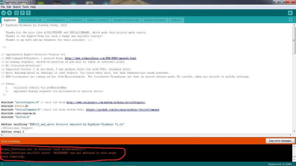

Hi I have error on compiling.
if your sketch is different from min please post it to my mail address:mhdker@gmail.com
all your done will be appreciated firstly
thnaks and best regards
Reply 5 years ago
Check whether you have installed the entire library correctly. And why in your sketch instead of the library "VarSpeedServo.h" is declared the library "Servo.h" and in the tabs of skews you do not have the Auger code VarSpeedServo.h (it is in the folder and should open with everyone). Also, you may have an older version of the Arduino IDE and need to install a newer version
