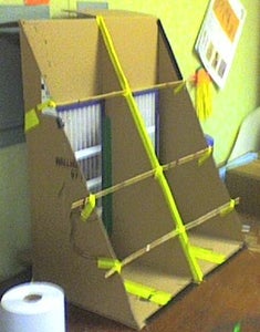

This is part two of the cheap spray booth. Using the same parts and a new box I created a bigger, better & Newer spray booth that works great and lets you paint on t-shirts.
It doesn't look like it... but this is pretty much the same thing in a different configuration. I used a box that was roughly 18" x 15" x 36"
I cut the box diagonally from to create two wedge/triangle shapes.
then taped them together to form one bigger wedge/triangle shape

Step 8: Sticks
I used bamboo sticks, again because I had them, to make stand-off for the art and so the t-shirt boards wouldn't get sucked into the filters.
I cut a little notch in the edges and the middle of the wedge/triangle shape, slid the bamboo sticks in and taped them down. (I use large paper clips to hold the paper in place when painting)
Step 9: Filters (+$4-$5)
This time I used much better filters... last time it was all about cheap. This time I used better filters that will actually catch smaller things as well as help with the smell. (this only raises the price $4-5)
the filters are just big enough to cover the hole that leads to the fan but small enough to fit in the box (The filters are 14" x 21" x 1"). You can use bigger, thicker, more expensive filters it just depends on how much you want floating around your room. If you are painting in a one room apartment you might want thicker, better filters and add a charcoal filter for the smell.
I taped them in using the yellow duct (duck) tape forcing all the over spray to go into the filters rather than around them.
Overall this set up works really well for larger things. If you only do model cars or smaller stuff... stick with the other one. I would recommend upgrading the filters for better filtration.
