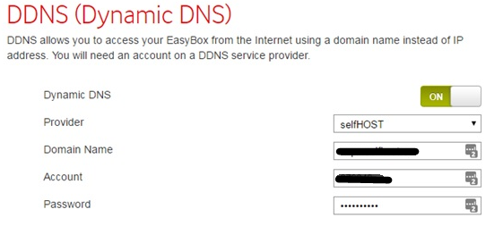

Configure DDNS setting
Provider: choose your service provider. Here is where you can see if your router limits you to certain provider.
Domain Name: the hostname you picked in Step 2.
Account and password: it is your log in information for your DDNS service provider.
