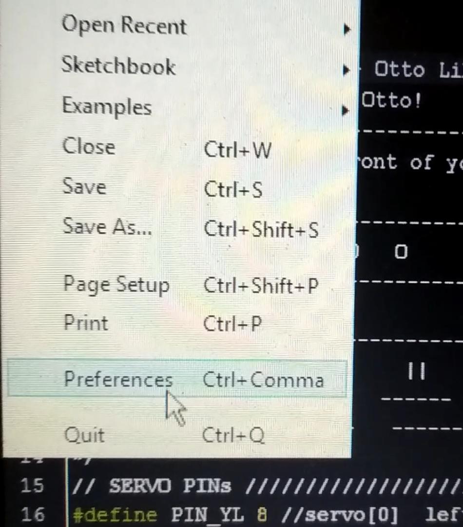

Step 12: Install Wemos D1 Board Library
  • Copy the link given below.
"https://dl.espressif.com/dl/package_esp32_index.json, http://arduino.esp8266.com/stable/package_esp8266com_index.json"
  • Open arduino and go to the file >> preferences.
  • Past the link as shown in image, if you already have a link separate it by comma.

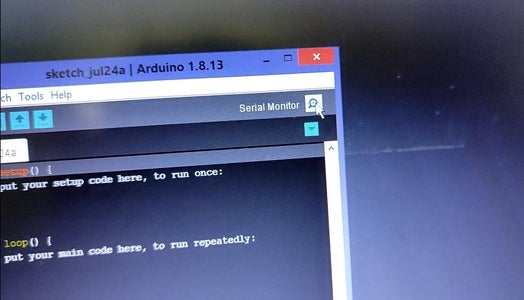

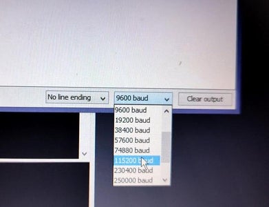

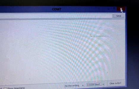

Step 14: Find IP Address
  • Open serial monitor
  • Select boadrate 115200.
  • Close serial monitor.
  • now deconnect your device and connect it again.
  • instantly open serial monitor.
  • you will see some ip address note the ip address.
