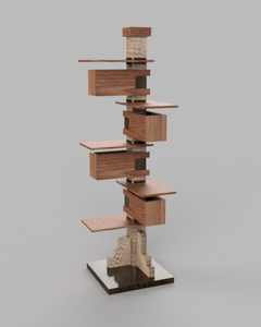

Step 1: Design Considerations
I wanted to build table lamp for a side table and/or night stand that should be about 30 inches tall, cast a pleasant indirect light, and have LED bulbs (rather than strips) that can easily be replaced as necessary. I started drawing a lamp using Fusion 360 so I could play with the appearance and dimensions before committing to a final design.
An image of the Fusion 360 design is attached, as is a pdf drawing for the post, supports, shades, and reflectors.

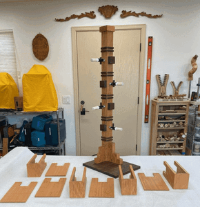

You will need to make four shades to cover the light bulbs. The shades are basically three sided open 'boxes' that slip onto the lamp post. They are made from 3/8 inch thick wood. Again I used cherry for its warm color. The width of the shade box should be slightly narrower than the lamp post so there is a friction fit when you slip the shade onto the post. The shade also has a 1.5 by 2 inch slot for mounting. A square pad (1.5 by 1.5 by 0.75 inches) glued to the post holds the shade in place. The pictures should make the mounting scheme a little clearer. You could glue the shade to the post, but that will make it more difficult to change bulbs in the future.
Build the four shades according to the pdf drawing, and make eight mounting pads; I choose walnut for the pads. Glue the pads to the post at the locations indicated in the drawing.
Step 5: Reflectors
In order to hide the light bulbs and provide indirect light you need to make five 'reflectors'. I used cherry wood again, this time about 1/4 inch thick. Like the shades, the reflectors are notched to slide onto the lamp post. The notch is 2-1/4 inches deep.
To fix the reflectors to the post I originally thought about cutting grooves into the post; but eventually decided that I would glue short rails to the post to receive the reflectors. Cut some strips of walnut to 1/4 inch square, then cut them to 1.75 inch length. You will need 30 pieces altogether. Each reflector will be supported at the post by a strip above and below, on three sides of the post. This way you can rotate the orientation of the reflectors vis-a-vis the shades. Lay out the location of the support pieces and glue them to the post. Use a cut-off from a reflector (same thickness) to space the support strips. Take a look at the pictures for clarification.
