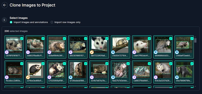

First is the object detection. I started off with a site called Roboflow. It had a nice dataset setup but seemed to want me to make calls online, which isn't much of an option over in the chicken coop far beyond the reach of our wifi. So, I opted to do the training locally. Turns out, that meant a week and a half of training each night. I may have gone overboard on the data augmentation... Either way, the model I trained is available within this project. It focuses on predators that I am confident are within my area. Unluckily, we moved to an area that has quite an extensive list in that regard. The model focuses on coyotes, foxes, hawks, opossums, raccoons, and snakes.

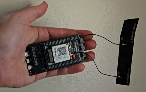

For running all the features we're putting together, we're using a raspberry pi from PCBWay. Part one, as discussed, is identifying the predator, so we have a very standard USB webcam for that. Next up is playing the audio, which just uses a USB speaker. After this, we get a bit fancier. To alert us of predators, we need to get data back to the house and to do something with it. For this, we're going to use Blues Wireless. I've been using a Notecarrier-F for some products that leverage Blues and I've grown quite comfortable with it, so that's what we're using here.
As far as hardware assembly goes, everything (including the Notecarrier-F) is plugged into the raspberry pi via usb. You'll notice that during the project development phase that means 3 usb devices plus a mouse and keyboard for a total of 5 with only 4 usb ports available on the Raspberry Pi, though. I just used a usb splitter for the mouse and keyboard and had no issues whatsoever.

With all the hardware in place, it's time to get into how it works. Thankfully, a lot of it is very intuitive based on what has been discussed so far. We have a YOLO detection model, and we use it to look for predators. I used YOLOv8, and all this training occurred on my PC. I did augment the data a bit, meaning that I included slightly altered versions of the training images to help improve the dataset. If I were to do this all again I probably would have skipped out on this; especially with blurring images (adding a bit of blur is an option when augmenting data, which made sense to me when factoring in movement and such). The end result I got has had some false positives for the brushtail possum, where it thinks blurs are an opossum. This can be rectified a bit by increasing confidence requirements for the brushtail possum in particular but, for anyone following along with the intention to train their own model, maybe train it without adding the blurrier images in the dataset. As far as training it goes, the dataset was well labelled from Roboflow including the bounding box for each animal, so all that was needed was to put a yaml file in the right spot so our training knew what data to process and where and to run the training.
Then running this in the same folder will get you up and running with a fully functional dataset:
pip install ultralytics
yolo task=detect mode=train model=yolov8n.pt data=data.yaml epochs=50
yolo task=detect mode=val model=runs/detect/train/weights/best.pt data=data.yaml
Note, this took me a week and a half of overnight trainings, but A. this is partly due to how much I included in the dataset with augmentations and everything and B. you can stop and resume training without issue.
