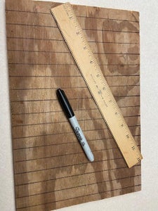

I drew lines across the top of the wagon bed. The lines are to represent the gaps between the boards. On the bottom of the deck, draw lines parallel to the sides about 2" in from the edges. These are to align the two main beams, the runners.

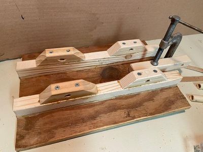

After drilling axle holes through the 1-1/4" sides of the axle holders, glue them to the runners, one 1-1/2" from each end. Clamp the 1" sides together. With the glue dry, glue and clamp the runners to the bed. The outside of the runners align with the lines you drew earlier. Clamp them into position and let the glue dry. Drill and countersink pilot holes and install two 1-1/2" screws in each axle holder.
Locate the bed centerline on the bottom of the bed for positioning the tongue of the wagon. Drill a 3/8" hole through the middle of the tongue about 1" from the front. Apply glue to the rear 4" of a 1" side of the tongue and clamp it the the underside of the bed, centered, so 2" extends past the front of the bed.
With all of the glue dry, on the top of the bed, locate the centerline of each runner and mark each about 1-1/2" from each end and at the center. Drill and countersink pilot holes and install three 1-1/2" screws through the bed into each runner. Drill and countersink two holes for the tongue and install screws to further secure it.

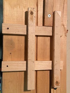

Make a rough jig that will hold the vertical rear rack parts while the horizontal rear rack parts are glued to them. Make sure the vertical bottoms are even and that the horizontals are perpendicular to the verticals. I applied the glue, positioned the horizontals, and weighted them down until the glue dried.
With rear rack assembled, hold it to the rear of the assembled wagon bed to locate the centers of the ends of the runners. Mark the verticals. Drill and countersink the verticals and the runners. Apply glue and install screws to secure the rack to the bed.
