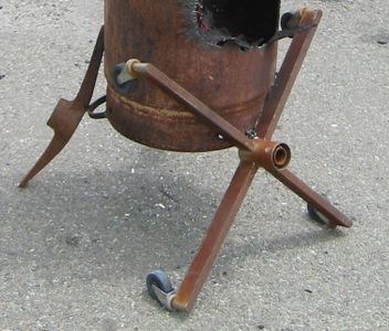

Make sure you do a good job of welding the legs on. You don't want Mr. Fire Face to fall over and headbutt and burn you while you're relaxing.
For the front legs we used the base of an office chair for a "skull-and-crossbones" look.
Also to give people something to put their feet up on without burning their shoes.
For the back legs we used a couple of pickaxe heads. We buttressed them with some curved bits of pipe scrap for extra insurance.

I welded the whole thing onto a shopping-cart-dolly to make it easier to move around.
